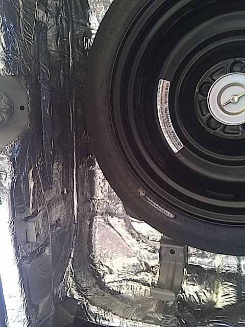

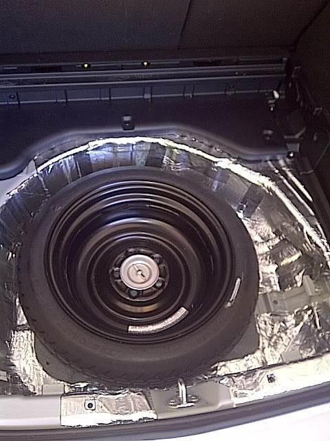

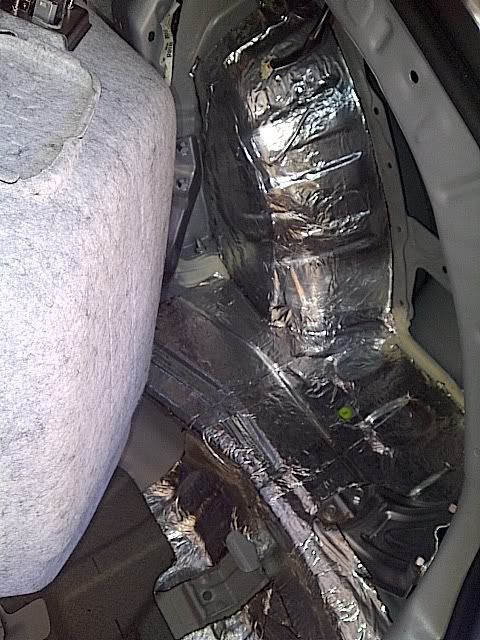

I plan on doing all exposed metal inside the car. I’m definitely going to cover the doors (behind the panels) and the rear trunk area including under the seats. I haven’t decided if I’m going to do under the carpets.
Dynamat is expensive so I bought this stuff which is WAY cheaper. It comes in 6" x 25' (12 sq ft) and costs about $17 from Home Depot. Very sticky stuff. I worked on the trunk area for about 3 hours and almost finished it. I just have one more wheel arch to do. The back area sounds quieter but really I need to do the doors and the front area in order to make a real difference. I noticed a lot of road noise from the front tires and it resonates through the rest of the car (stupid OEM Dunlops probably don’t help either). The tinfoil tape is mainly to cover the seams where the tar tape seams meet. Here are some pics so far.

My brother in-law did his Nissan Juke in this stuff about a month ago in the Texas sun, no issues so far.

Yup, worked great. I went through the hotest summer on record in Texas and it held up great. Very nice, cheap mod.

Well, mine worked fine and I can tell you there is less road noise inside the cab. You guys do what you want or don't want - just letting you know what I did and my experience.

It's been almost 2 years in the Texas heat (record breaking summer last year - 42 straight day sover 100 degress) and still working perfectly. Worked fine for me and it's a one-time installation.
You guys do what you want and can afford, don't hate. I don't critique people when they paint stock rims red with a spray can or put band-aid sticks on the rear quarter panels.
